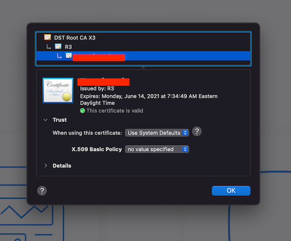

Yeah, I used the ACME script. I’m not sure how they could be generated incorrectly - I did do a manually inspection of the files in the acme folder and they do appear to be fine. I also assumed that the automated cert process worked because I do get this on some urls (typically once I can log in):
Screen Shot 2021-03-24 at 7.10.19 AM

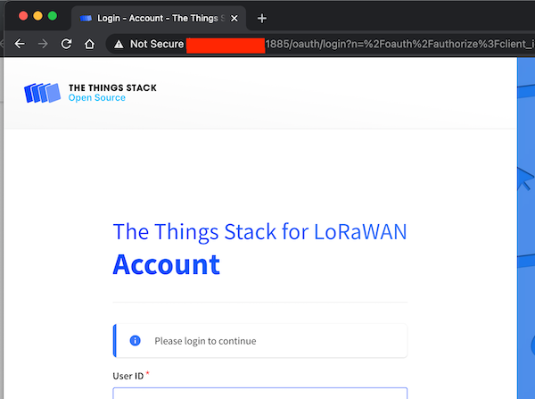

But I also get this on most of the auth urls:
Screen Shot 2021-03-24 at 7.11.25 AM
This is the only way I could get passed the token error, but adding env variables for those routes that tell it to skip SSL.

It definitely looks like your certificates are being retrieved correctly. Unfortunately, the only thing I can recommend is starting over, and leaving docker-compose.yml as is, i.e. don’t add those environment variables.
Once you have updated ttn-lw-stack-docker.yml with your server address, client secret, and http keys, run docker-compose run stack config to verify that your configuration settings are all loaded correctly, and you should be good to go.
