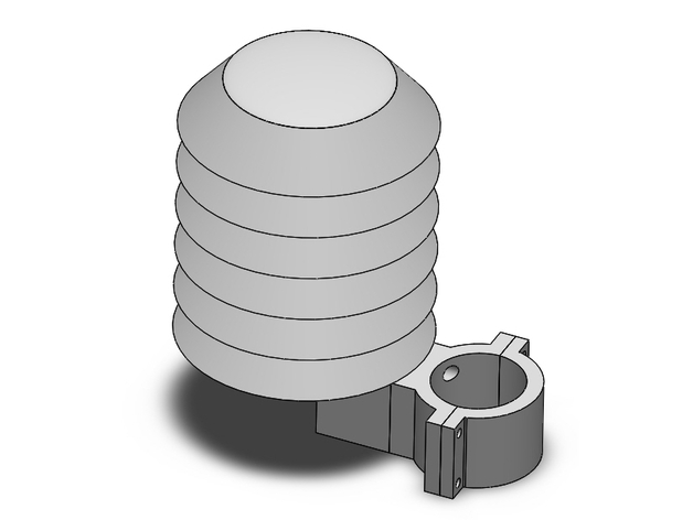

If you had a printer…
tnx I ordered one to test … like that it’s very compact
Cool but suboptimal. Did some tests with different DIY Radiation shields. And now i use Davis 7714. Expensive but serious. Another compilation for this theme: https://www.allmeteo.com/radiation-shield-comparisons/

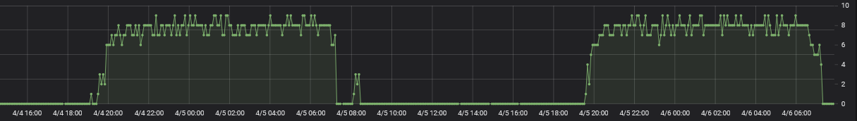

The luminosity data from my node, since the code change, looks quite strange:
plot of luminosity data from two days.
Do you light the led when reading luminosity ?
