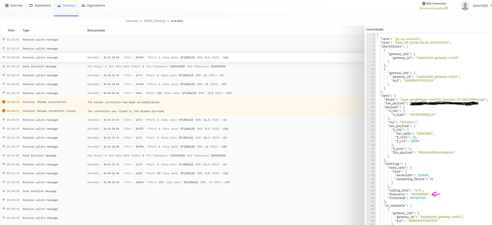

The gateway is receive all teh 8 channels. For example the 867.500MHz:
