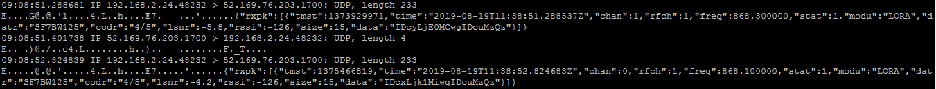

please, my RAK 831 Gateway is well set up and the gateway is receiving data as i can see on my raspberry terminal with âsudo tcpdump -AUq port 1700â. My challenge now is to sniff the lora packets directly from the gateway using Node-Red without having to connect to the things network. Is there a way i cam do this? this is a screenshot of data coming in from two nodes to my gateway.
you could build a local server. not connected to TTN
thank you for your reply. well my aim is to use internet as minimally as possible, hence my need to use node red so as to maintain and all LoRa communication. to be clearer, i want to grab the packets directly from the gateway terminal as the arrive and save or log them to make graphs and chats of my sensor reading without needing to use internet of wifi to upload them.
Thanks
As already explained, you can run LoRaServer or similar locally. Or you could just run its gateway bridge and MQTT broker and get the data that way. Or you can listen to the UDP traffic, it is documented in a file at the top level of packet forwarder source code, took me a few hours to put together something in python to collect and reformat it (I canât share that code as it belongs to a client, but get a python UDP âecho serverâ example and a python JSON example and put them together informed by the semtech format documentation).
But realize that you are going to have to implement decoding for the packed and encrypted LoRa traffic. And if you want anything like adaptive data rate or over the air activation, you will have to implement support for that too. So youâll actually end up building your own LoRaWAN server to run locally. If you have unique needs that can make sense, if you donât you might use an existing piece of software.

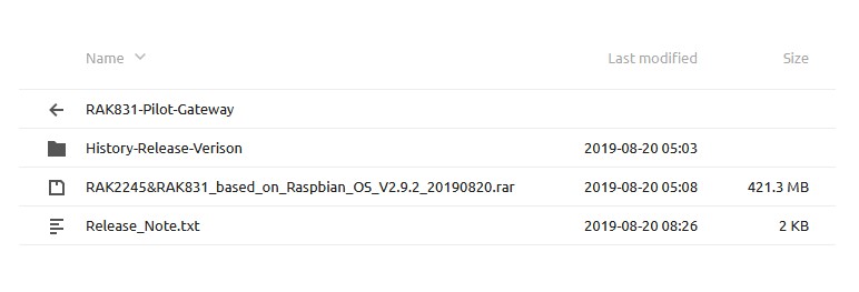

Could someone please direct me to location on HOWTO setup a /LoraWan-Gateway/Rasp pi 3B/RAK831 .
I have found a couple of locations but the Links in instruction are not good links.
I would greatly appreciate any and all help.
The latest RAK common gateway software actually already has Loraserver included.
(The gateway itself is on topic here but Loraserver is not.)
What locations/instructions and which links are not working?
You may have a look at this thread: RAK831 with RPI 3B+ suddenly not working anymore
On RAK Wireless downloads you can find ready made images that can be written to SD card.
These images also have Loraserver installed which is not needed and not used when using the device as TTN gateway. There is a setup menu with an option to configure the device as TTN gateway (see included documentation for details).
