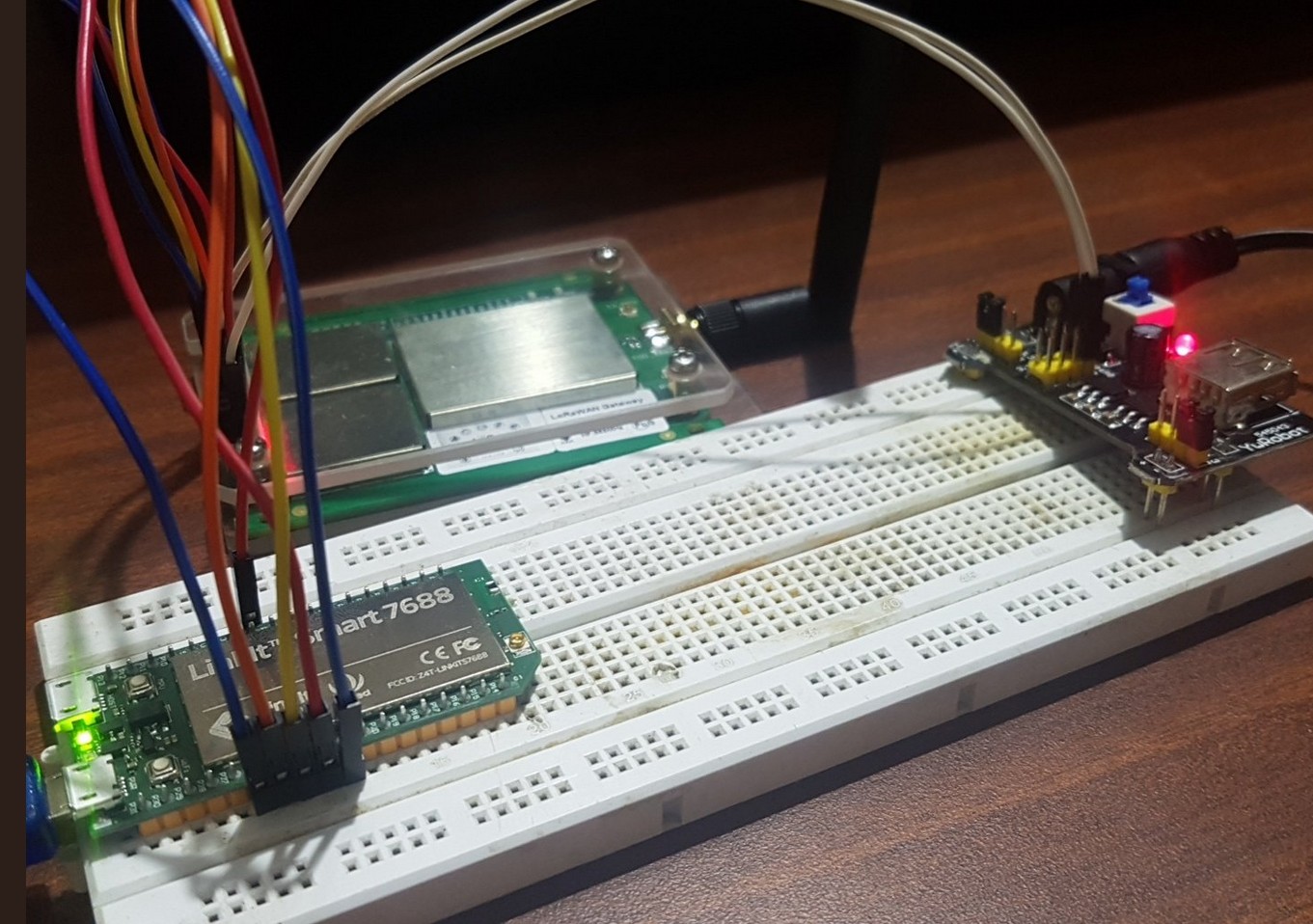

source : https://twitter.com/narioINC
That one looks super neat, but the guy doing it said the device has a ‘half duplex spi issue’, which makes me wonder if it’s worth it at all, in the end, RPi Zero is even cheaper and proven to work.
which board are you talking about re spi issues?
LinkIt board
Talking about OpenWRT to drive concentrator is a really great idea.
I could try with $9 Onion Omega 2, may be I’ll give it a try with my designed
Power Shield favorited on june 2-bullet-tuesday
@Charles @gonzalo I cross-compiled the poly packet forwarder and tried to run it on the Omega2. The PPF was “unable to start the concentrator” because of issues with SPI.
I analyzed the data on SPI dev and can confirm that the first bit is low (instead of high) under certain circumstances.
Omega2 is afaik mt7688 as well. And as such it is currently affected by the same SPI bug as the Linkit7688.
So the above patch could work too. But this requires that you build the whole LEDE/OpenWRT yourself.

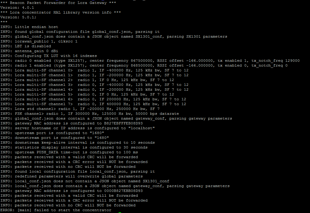

Hi guys, I also bought RAK831 board and i’m struggling with it.
i follow the tutorial https://github.com/Lora-net/packet_forwarder/wiki/Use-with-Raspberry-Pi
which use semtech packet forwarder and HAL.
but when i execute lora_pkt_forward, i got this result…
can anyone give me an advice?
Also, powering 5V from RPI to RAK831 cannot be a problem right?..
ps. i want to use local network sever, not ttn, for research.
best regards…

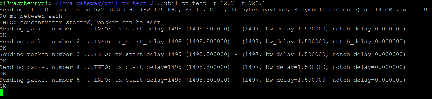

hi,
Could you try and post the output of test_loragw_spi and test_loragw_reg commands tools that is generated during the build process of the lora gateway HAL.
There is also a util_tx_test command that will just run and do some transmission testing
you can run it like so from a linux terminal:
$ ./util_txt_test -r 1257 -f 866.5
I found how to figure it out.!!
but in lora_gateway source, reset_lgw.sh script is not working…
then I reconnected 5v pin and GND pin of RAK831 several times , then it’s working.
do you know the problem?
