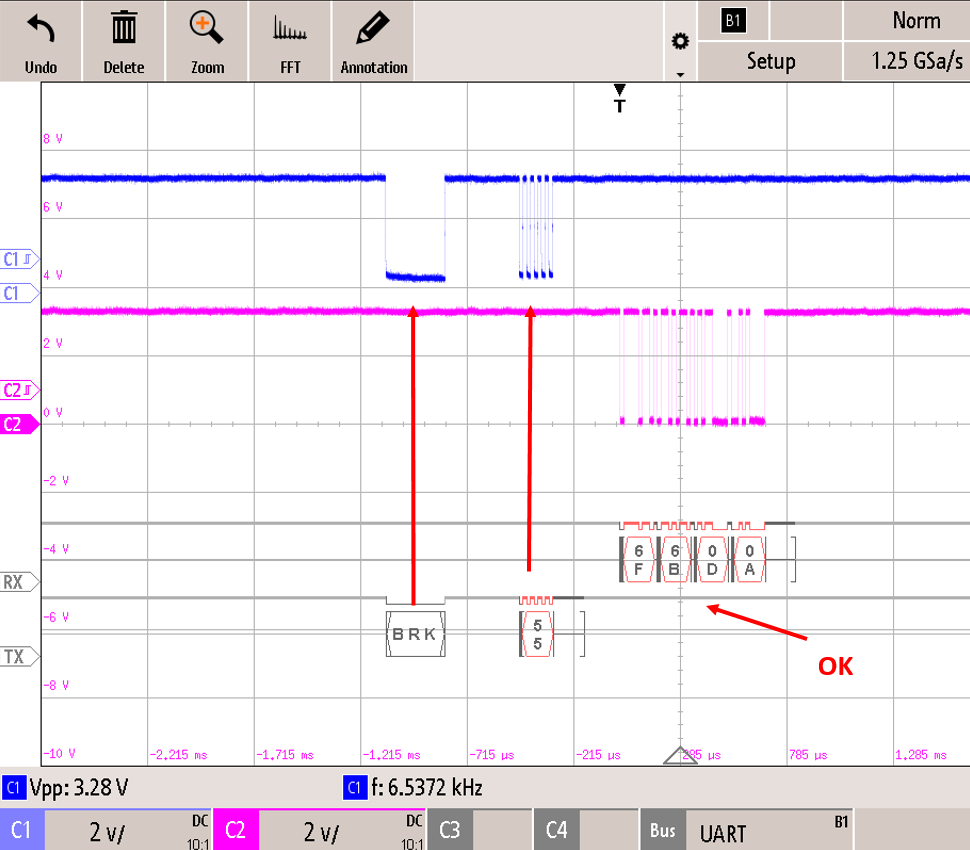

I also changed the timing for wakeup condition (break 300µs + 0x55) like in the picture. The answer from the modul is OK.
Problem captured and solved. In a function i had send the sleep command twice.
