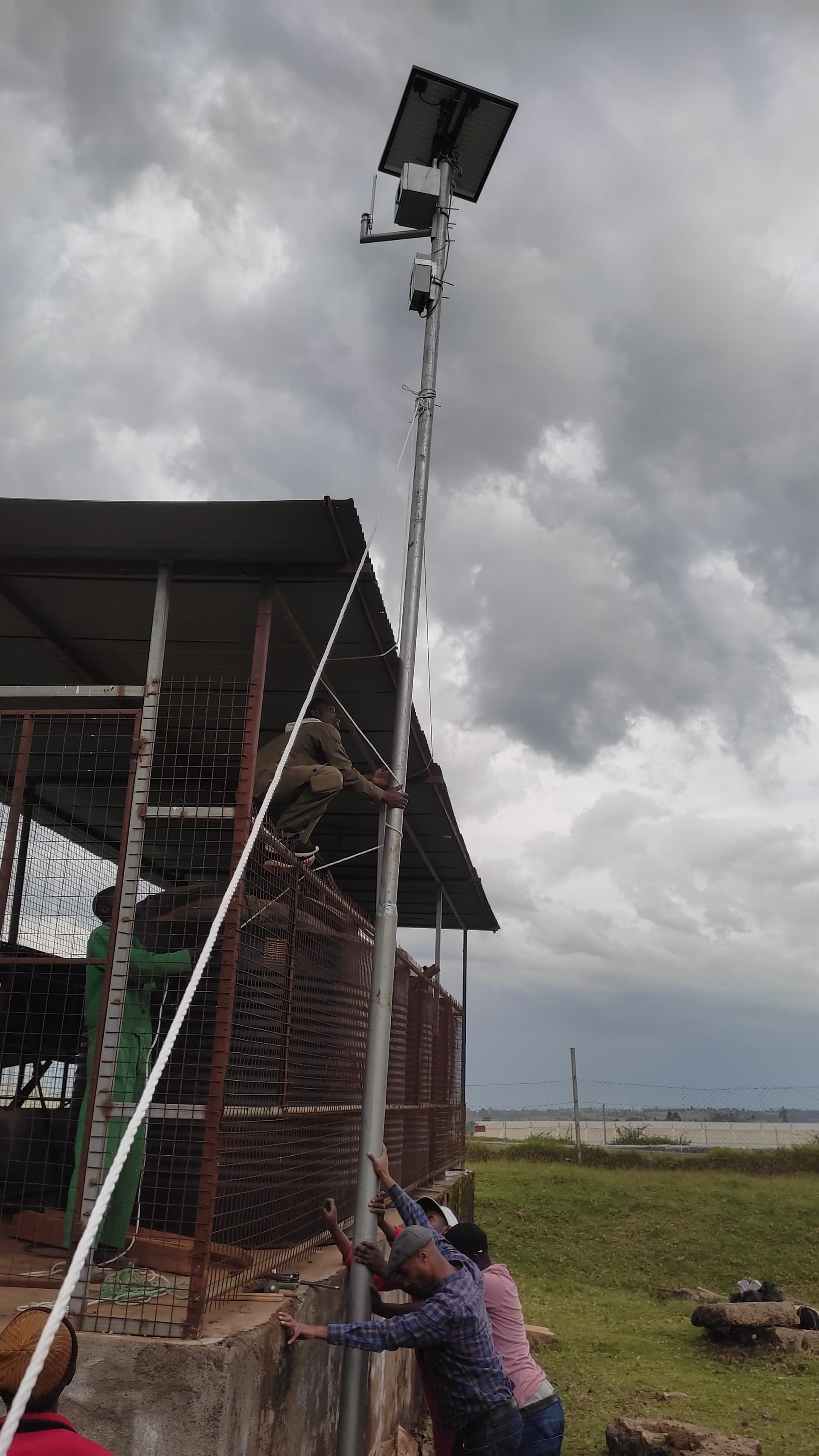

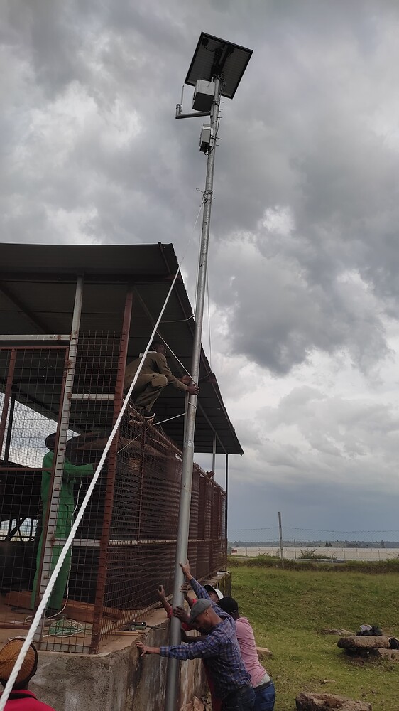

Which one?! There are several GW’s mentioned in the thread above! Have you measured the 24hr power consumption of the GW you are using to establish a start point for balancing needs with the panel/battery configuration. Remember the panel has to both power the GW and provide enough power during the hours it is feeding to top up the battery pack. Have you determined what the useable capacity of the battery pack is? (It wont be the full 12000mAh - look to something like a range 20%-80% opoerating for maximum service life…if you can top up to >80% most dayas and ideally 100% that is a safety margin rather than guaranteed every day as you need to allow for the odd poor day/extended rain etc… even in Kenya! Check what the conversion losses are if possible - power is lost at various places in the power chain. What is the nominal operating voltage of the GW, have you tested for lowest point where it will brown-out/drop out? What is the lowest delivery voltage/capacity point of the battery pack where it will cut off to protect itself? Obviously a marginal system will drop out early in the morning before dawn so one trick is angle one of the panel a small amount say 10-20deg towards the east so it starts to capture even as daylight starts - most modern panels give a good output even without full direct mid-day sun so you wont be sacrificing much capacity overall by doing that and it may help last gasp - I had one system that typically dropped offline at sunrise +/-~30 mins depending prior days inputs in the depths of winter until I tried that - I later increased battery from 35Ah to 45Ah when I got the chance and solved problem at source so to speak!
…but frankly if system that marginal only option is a 3rd 30W panel or better yet increase battery capacity…insticts tell me you need to be at 20000mAh absolute min, probably 24000mAh for safety - even in Kenya! Is the panel in full sun all day or is there any building or tree screening that can impact? What is the available capacity hours for the location (GIYF)
12v 500mA
Well the farm has so many greenhouses, which are way bigger than myself, cant see the gateway which is on a 10 meter pole at the highest point, however some devices connect on the less sloppy side.
its evenly split at the equator, sunrise at 6:30am and sunset 6:30 ish in the pm. ofcourse no day is the same with cloud cover but often rains in the evenings (lakes in the highlands). Also as you mentioned my panel is facing the east at a slight angle, to maximise that morning sun after the night. Nothing is obstracting it.
