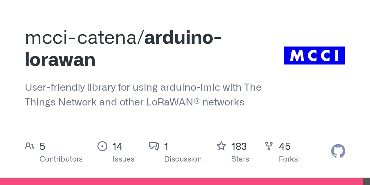

You mean this library?
Looks like it is only for 32b mcu’s. I got lost in all the *mic; *cci libraries - all have same name.
