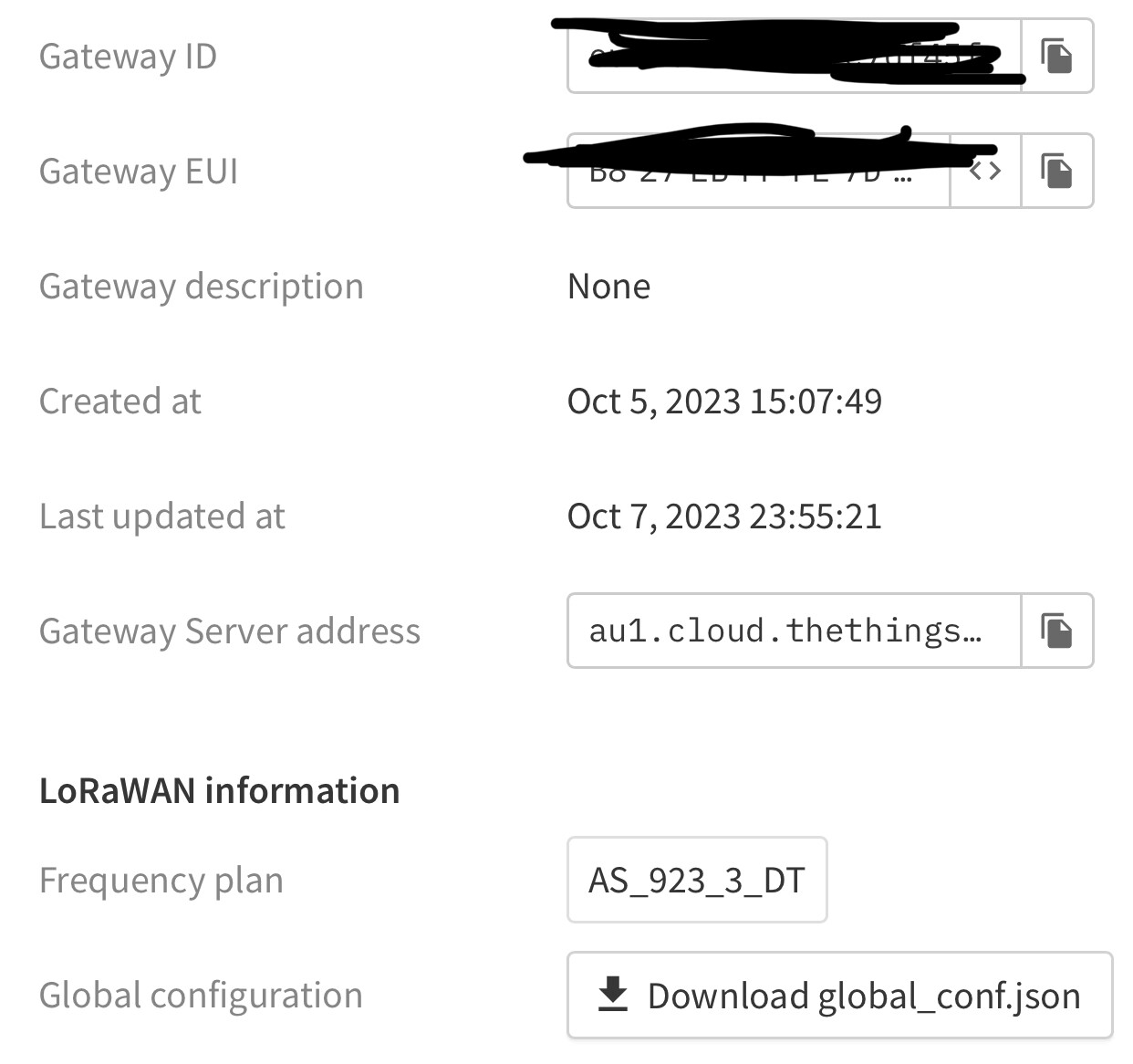

here how did you configure the gateway
i can actually tell you you put “region”:“AS_923_3”
Asia 915-921 MHz (AS923 Group 3) with only default channels
ID LoRaWAN Band ID Base Frequency Description
AS_923_3 AS_923_3 915 Compatibility frequency plan for Asian countries with common channels in the 916.5-917.0 MHz sub-band

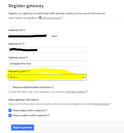

if i recall correctly i used
Asia 920-923 MHz with LBT
AS_920_923_LBT AS_920_923 915 TTN Community Network frequency plan for Asian countries, using frequencies ≤ 923 MHz with listen-before-talk

Hi @Piet_Pillay you mean I should change my gateway’s frequency to Asia 920-923 MHz with LBT? As I checked my gateway frequency is as below i.e. AS_923_3_DT
Don’t you think configuration of my gateway are fine? Since whatever the configuration be it is able to get data from my friend’s nodes… hence if it is able to work with his node then without any changes gateway should connect with mine, isn’t it? Please advise! I have attached the global_conf.json

if i read the description of AS_920_923_LBT i would consider changing to it

But to be on safe side I can try what you say however it might get complicated since making a new gateway on TTN console with same gateway ID will give a issue so will need to change something in my gateway firmware i guess. I will do what you suggested, but I think, I will prefer to do it when I am almost gonna die solving this :smiling_face_with_tear:
