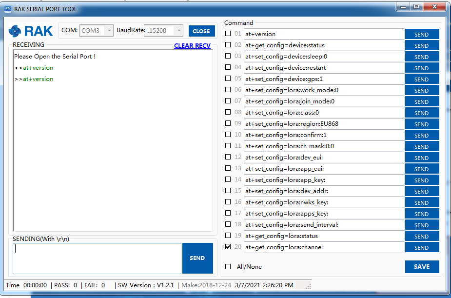

I chose the Port Number, and then open, but when i send AT command at+version, i do not receive firmware version number. i would be thankful if you could advise me what i miss. 0

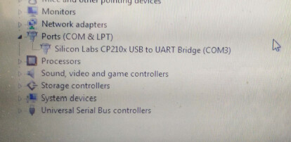

Can you check in Windows Device Manager which ports you have on your machine so we can be sure you open the right one.

@descartes Thank you very much for your quick response. yes, i checked and opened the correct port as it is written in Windows Device Manager, and it is COM3.
but i donot receive firmware version by at+version command as shown in my previous pic or any other command response.

@descartes yes, but but i do not receive firmware version by at+version command or any other command’s response.
I am totally aware that you do not receive the firmware version, which is why I am posting replies, but first I was trying to eliminate the obvious problems.
But now we know you are connected to the correct COM port with the device driver installed, whilst you are in the serial tool, can you press the reset button on the board, which as @Jeff-UK suggests, should show the boot messages from the board.
One possibility is there may be an issue with USB cable, so worth trying a different one.

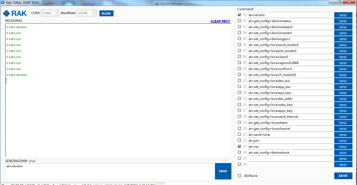

actually none of the commands work and I do not get any response entering commands (even at+run) as you see in the pic. i tried another USB cable, but still the same. should i try another BaudRate?
.010
Did you try the reset button?

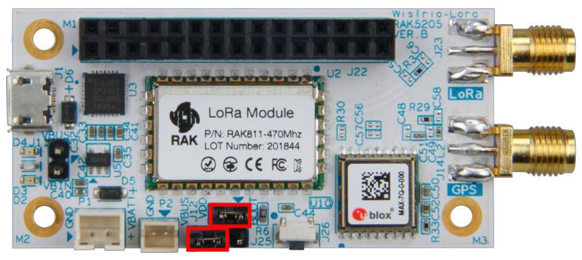

Should be on the front edge of the board, to the right of the jumper pins in red:
RAK5205
Also worth checking you don’t have the BOOT jumper on - as that will force it to wait for programming firmware.

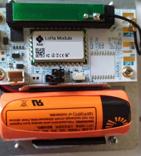

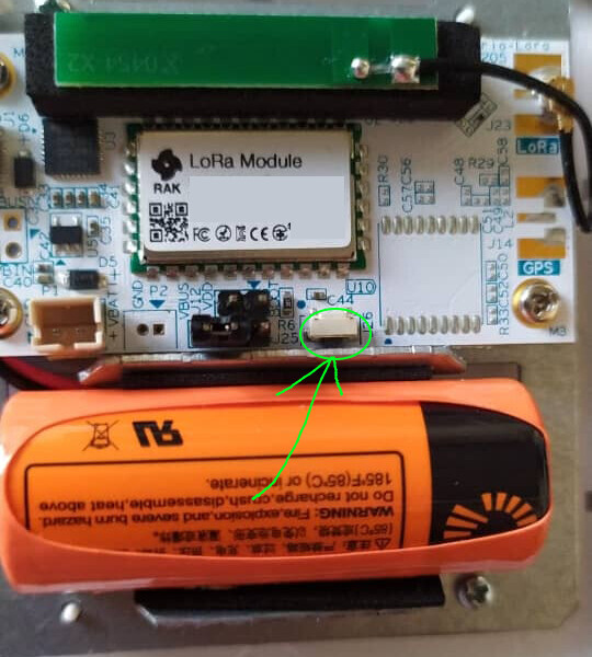

it is the picture of my board. there is no button on the board.02-WhatsApp Image 2021-03-07 at 21.08.28
image The button is right there in the green circle.
Did you check the battery? With a dead battery, the device will still appear on USB, but you will not get a response if you send a command.

Did you check if the BOOT0 jumper was on J12?
