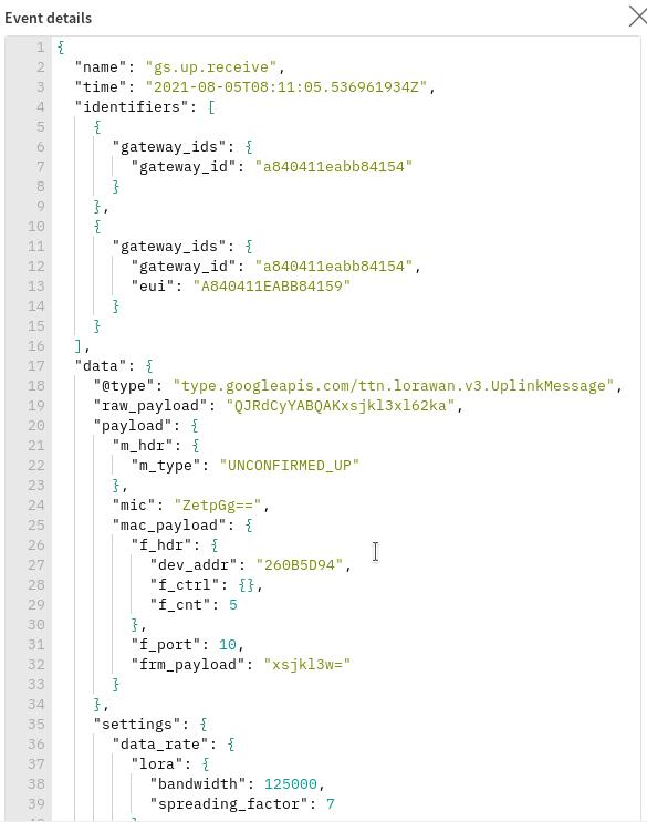

@al1fch OTAA method is not working out, however on using ABP method, and applying the command AT+DTRX=0,1,4,01020304, it shows āOK+SEND:04ā followed by āOK+SENT:01ā. However, on view the TTN gateway live data, I got the result as attached on the screen shots. I could not decipher the frmpayload which i think is bound to be the actual data(sent from e-87 endnode). please do refer to the refer screenshots for a clearer understanding.
'look at and show payload ā is not a gateway job .
(the postman does not open and read the letters !!)
Go to console / Application/End-device screen to see , for your end-device itās own live datas with the raw and clear payload (the second according to your specific payload formatter )

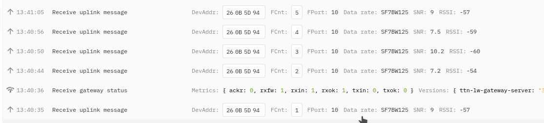

@al1fch Sir, thank You so much for the reply. I opened the application/end device/live data screen, but nothing is updated on screen, expect for the message ācreation of nodeā¦updated location settingsā. It is only at the gateway live data screen, where i generally obtain the msg
"receive gateway status Metrics:{ackr:0,rxfw:1,rxok:1⦠"
and after applying command AT+DTRX=0,1,1,00 from serial terminal, it shows
" receive uplink message DevAddr:260B5D94 FCnt:4, FPort:10, Datarate:SF9BW125 SNR:7.8 RSSI:-59 " at the gateway live data window.

@al1fch the issue was due to wrong frequency selection. finally the end node shows data at the live data session of applications.
