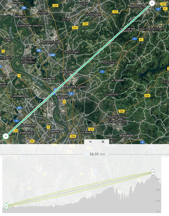

No connection to the nearby gateways, just to 36 km away

That EUI looks a bit dodgy, like someone just made it up.
Still weird that you can are received by that one, and not others.

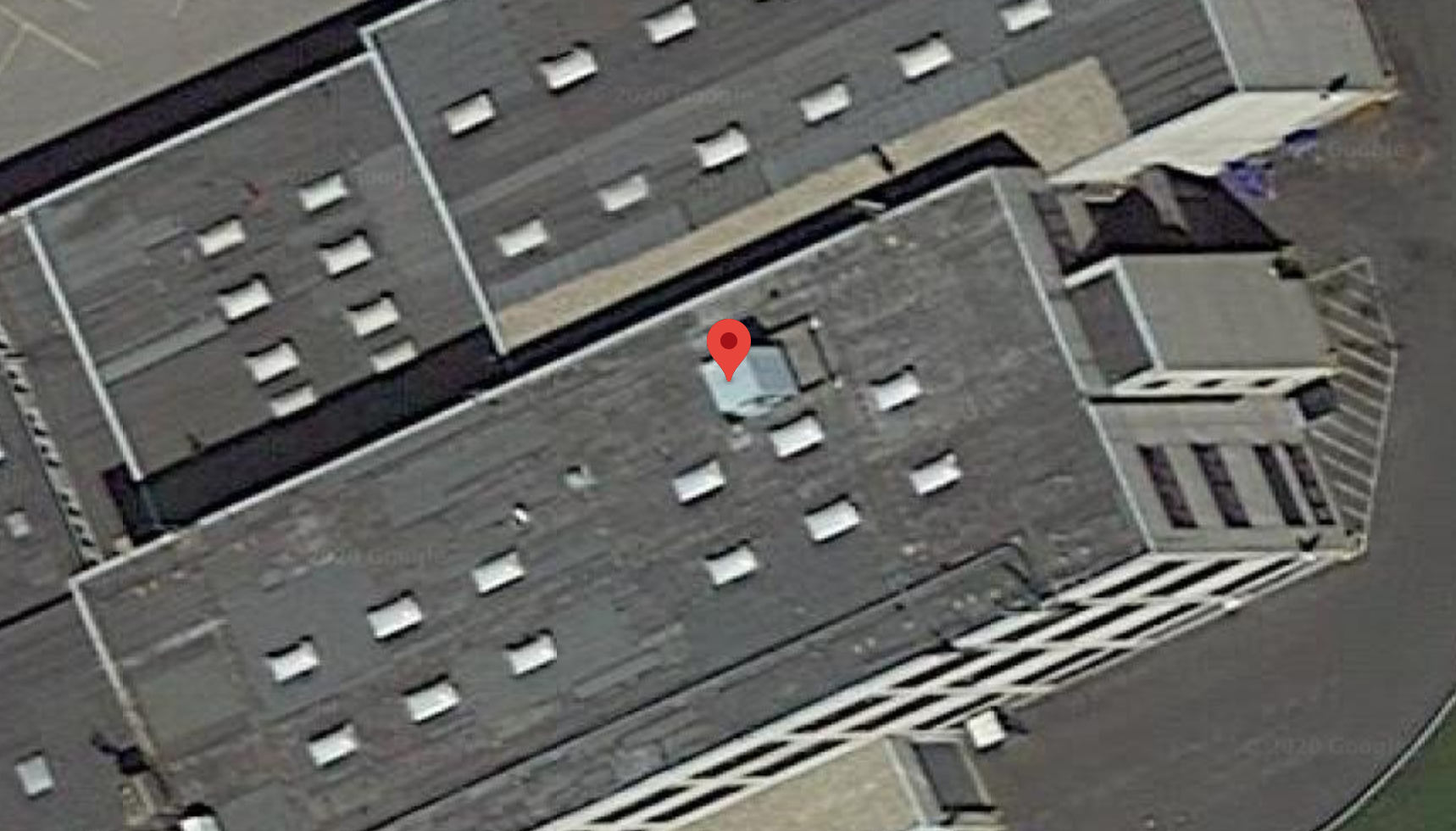

EDIT: I can find the following information for this EUI on https://www.thethingsnetwork.org/gateway-data/ :
“eui-0908070605040302”:{“id”:“eui-0908070605040302”,“description”:“Boltenburg Unternehmensgruppe, Standort Remscheid, Service-Line: 0700 - 80 80 80 08”,“owner”:“hartmut-boltenburg”,“owners”:[“hartmut-boltenburg”],“location”:{“latitude”:51.18321709,“longitude”:7.22158692,“altitude”:398},“country_code”:“de”,“attributes”:{“antenna_model”:“Procom CXL 900-3LW-NB / 868 MHz mit 32m Koaxkabel LCF 78/50”,“brand”:“Four-Faith”,“frequency_plan”:“EU_863_870”,“model”:“F8L10GW EU 868”,“placement”:“outdoor”},“last_seen”:“2020-09-29T11:19:55Z”}

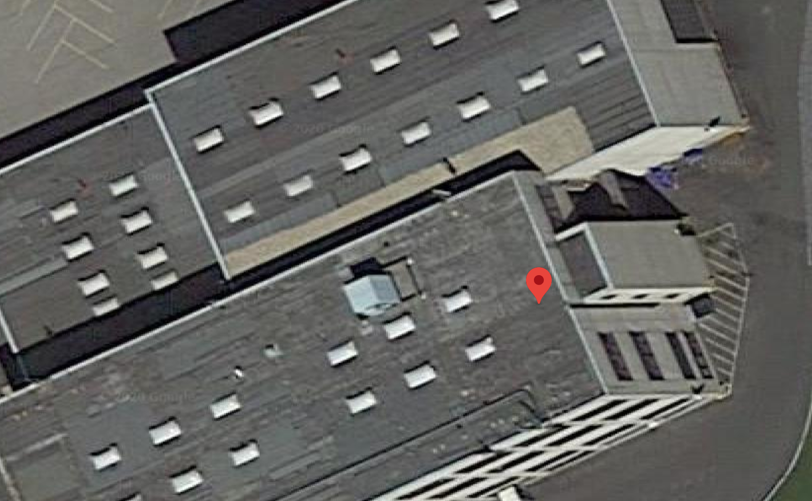

This information gives a different location: https://goo.gl/maps/noAmJVGjooH8jNoZ9
Nice find, but not that much different? https://maps.google.com/?q=51.18321,7.22183 vs https://maps.google.com/?q=51.18321709,7.22158692
image image
Uplinks include the current GPS coordinates, if any, that the gateway may include (which may be fake; TTN cannot tell). And it seems https://www.thethingsnetwork.org/gateway-data/gateway/eui-0908070605040302 returns some older cached value, or more likely whatever has been entered in TTN Console.
The gateway of the Boltenburg Group near Remscheid is abt 300m MSL high. It looks from above down to the river Rhein. It should be no problem to “see” this gateway from the west of Cologne. This gateway has a huge coverage.
yes, that gateway is in a really nice place indeed, topology-wise - link to the location (west of cologne) given above is entirely possible.
link
Sorry, I must have made some typing mistake when looking them up. The locations are indeed nearly identical, so no cause for concern.
