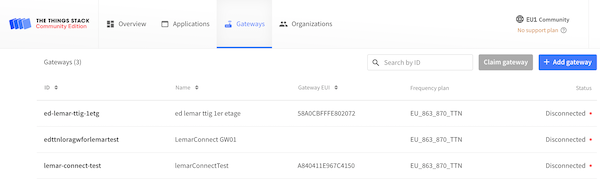

Hello, Except that it’s been 9 hours on my side since I registered a TTIG and the status is still disconnected. I give training to let you know but I find it more complicated to switch to V3 than V2
Did you power off/on the TTIG? That way it got connected within minutes.
I turned it on, off, moved it, changed the wifi configuration, turned it off, then on again … I have the LED which lights up green and stays on continuously. However I still have Disconnected.
I am using: EU_863_870_TTN and the server:
eu1.cloud.thethings.network
I had read somewhere that you have to wait for it to be active but the concern is that I had TTIGs bought for participants and there they will just find that it does not work

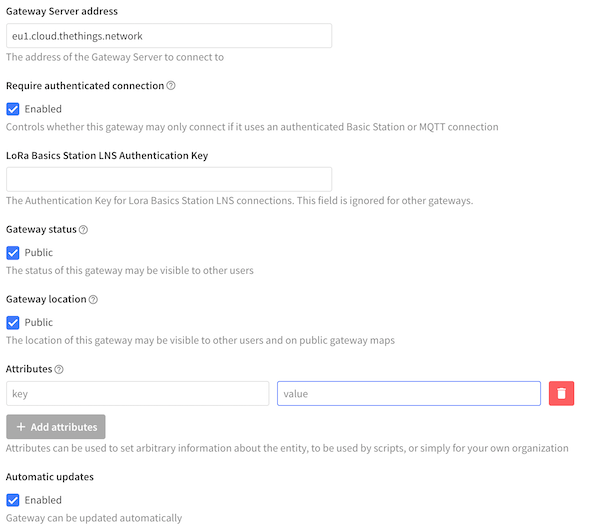

Do you have the four magic parts (LNS Key plus the three attributes) as seen in this screen shot?
Your values will/may be different.
If not, delete it and try again. This is a current (as of mid-July) fix, not great, but there are two senior TTI team members looking in to this, but in the meanwhile, delete & retry has worked for many others.
Once the settings appear, a simple power cycle will speed up the TTIG reading the new settings. Changing WiFi isn’t a thing.
Once it takes you should see status reports in the gateway web console (you may need to turn on verbose mode).
The acid Jeff test is device traffic if you have one you can trigger on demand.

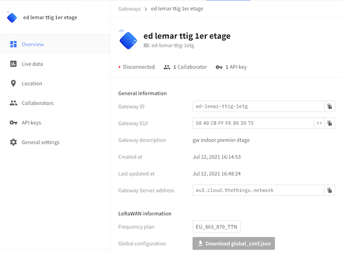

Hello Krishna,
Thank you for the message. For me all the stages went well. And I remain on the status disconnected. My EUI is as follows: 58A0CBFFFE802072

@James32 It looks like you just registered your gateway and did not follow the claiming process:
https://www.thethingsindustries.com/docs/gateways/thethingsindoorgateway/
Your gateway is just registered and not claimed and hence is not connecting. Please check the docs above and follow those steps.
Ok so I don’t understand because my gateway had never been registered before. Therefore it seemed to me that it was necessary to follow the following procedure in the document:
