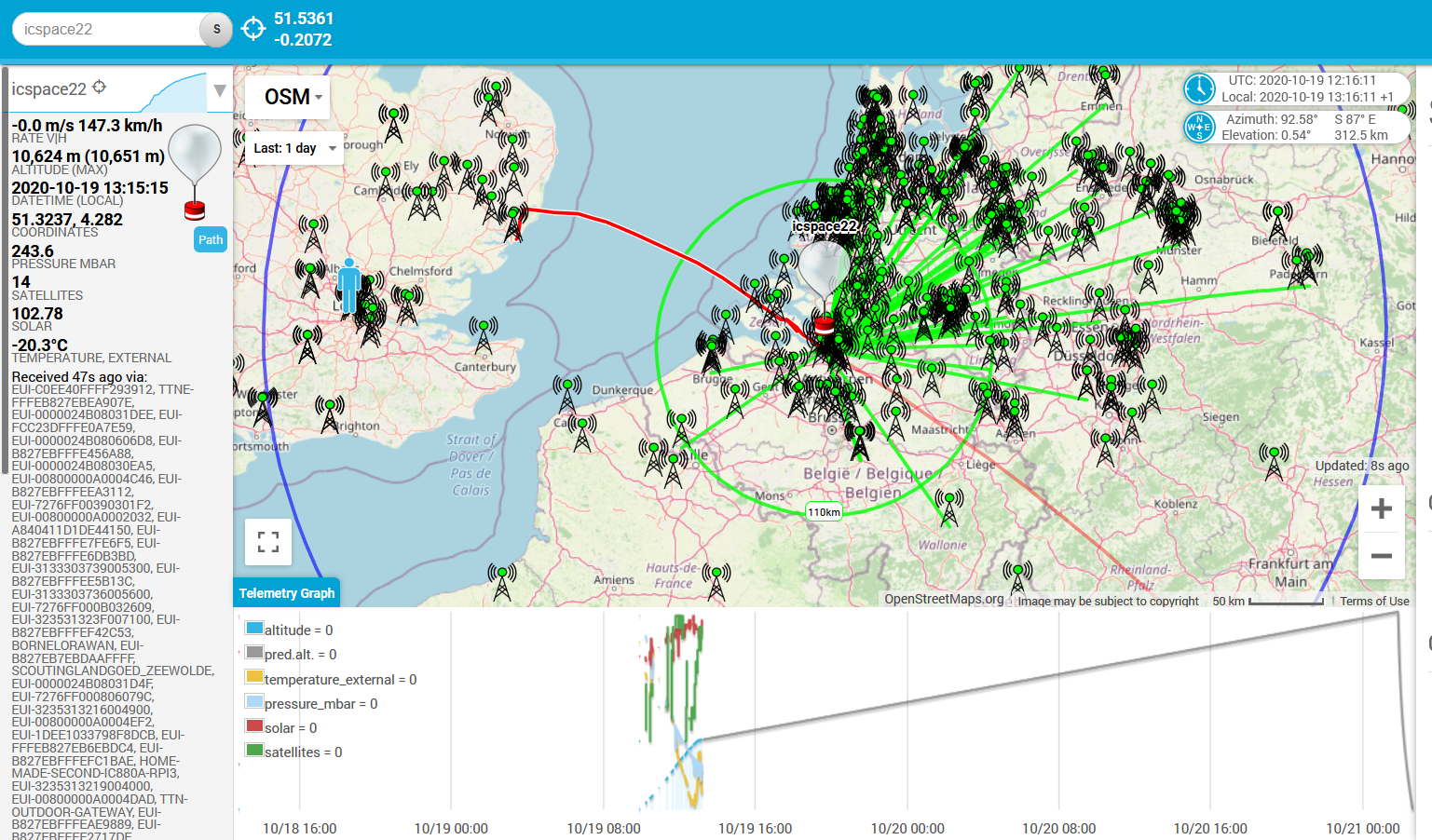

Jakub, in my high alititude flights from the United Kingdom, we have no issues getting our data picked up with SF8 and SF7. With direct line of sight, the spreading factor does not make a difference at all(from experience). Over the Netherlands, we have had nearly 400 gateways pick up our packet. See picture below. We have had good coverage over Belarus, Romania and Slovakia. At least 2 gateways pick up transmissions there.
