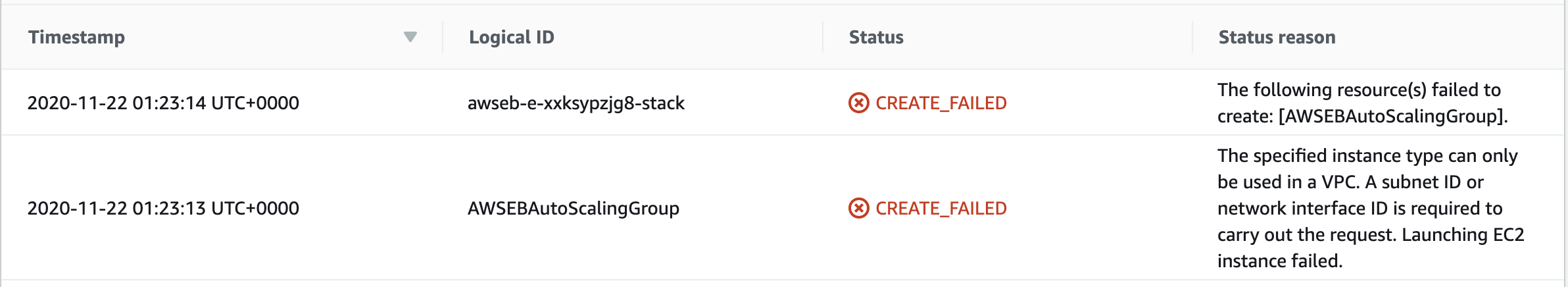

I’ve also been able to move forward by modifying the template offline and uploading again. However, I am running into the following errors when completing the CloudFormation step
2020-11-22 01:23:13 UTC+0000 AWSEBAutoScalingGroup CREATE_FAILED The specified instance type can only be used in a VPC. A subnet ID or network interface ID is required to carry out the request. Launching EC2 instance failed.
I recreated a new EC2 instance and tried again, just incase my existing instance was limiting in some way, but the same errors with the new instance
Thanks
This is now updated, CI needs another ~10 minutes
