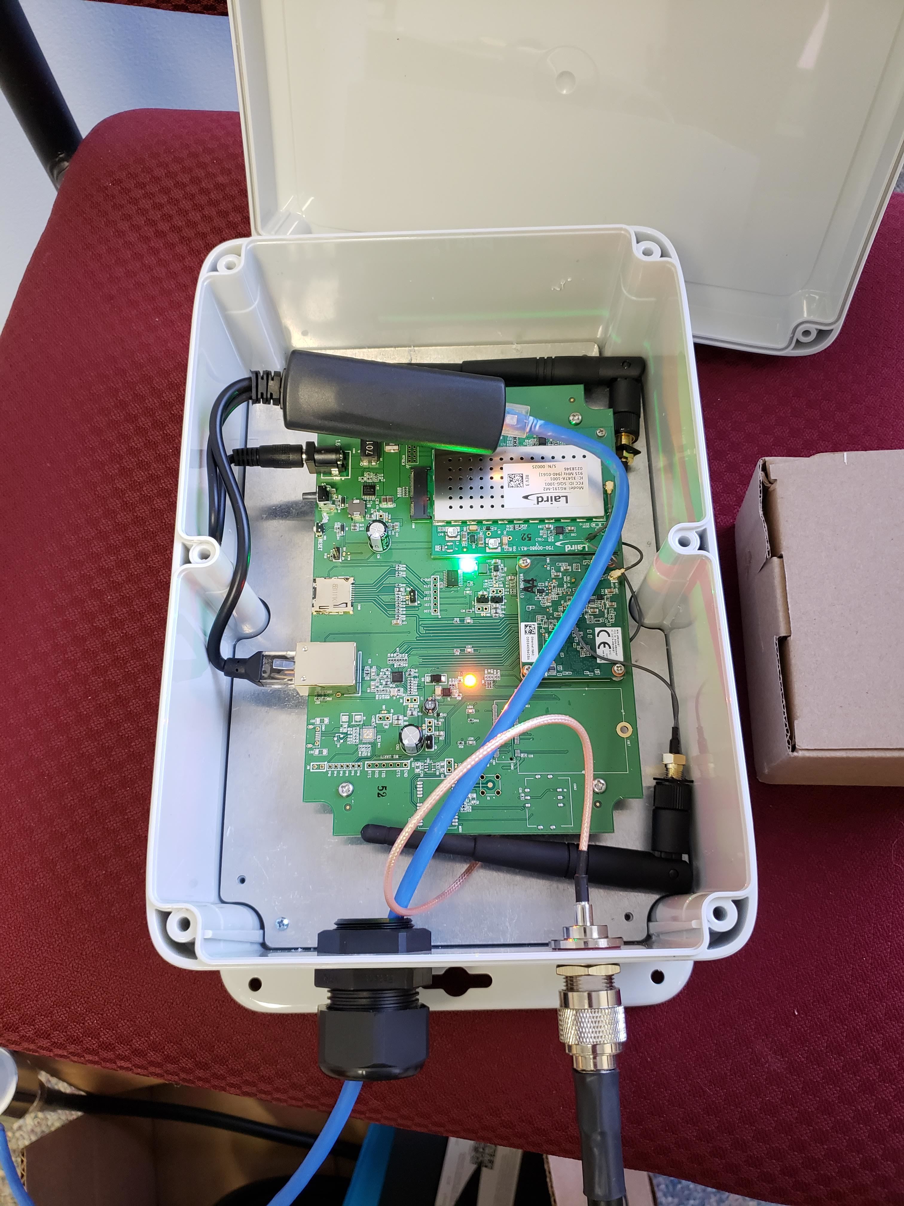

Laird: Sentrius RG1XX
I just put together a Laird RG191 in an outdoor enclosure with mostly everything to get the job done. Of course the antenna cable and ethernet cable lengths are customized for the site! Including links for easy purchase from US based vendors… none of these are affiliate links btw…
I welcome any comments!
Not included in the list: board standoffs… mounting pole…

Here’s the right part for the cable gland https://www.mouser.com/ProductDetail/Heyco/M3234GBH
