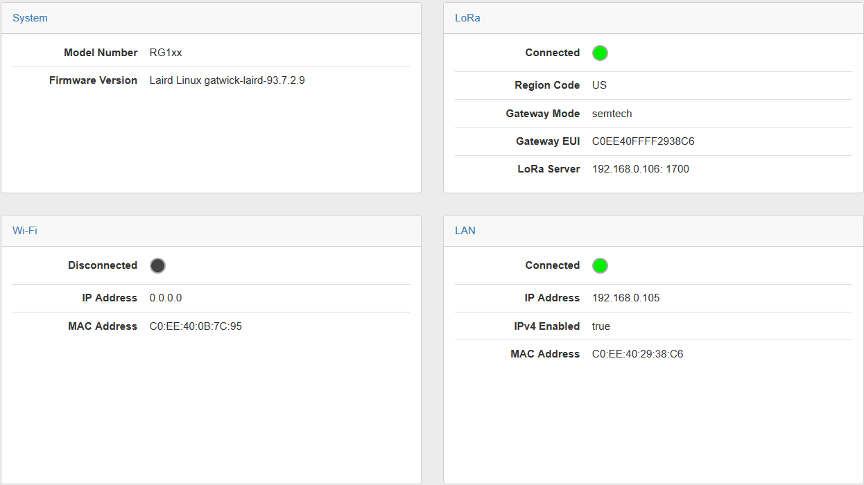

This is my gateway’s dashboard:
Do you have any idea why I am not getting messages from the “gateway/mac/rx” topic?
