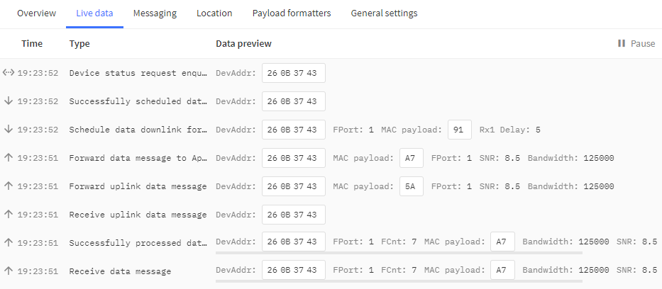

I have a bit of a silly question, I’m not sure if what I’ve done has worked or not. I’ve followed the guidance in this forum post to create a new device in the v3 console, and I get the same live data as @rvdvoort , which leads me to believe that it it is working (even though it seems to be scheduling downlinks):
However, the downlink counter is incrementing on every uplink:
Is this correct or have I messed something up?

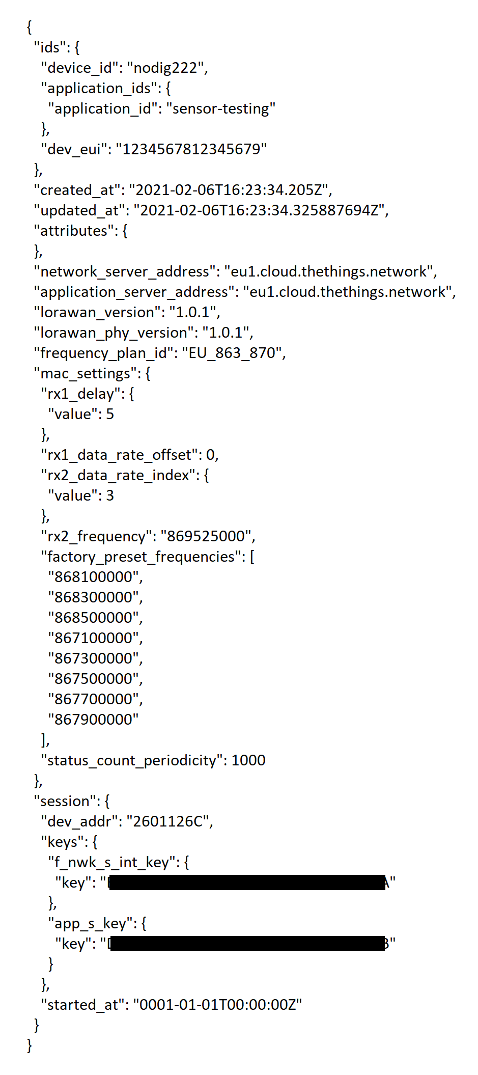

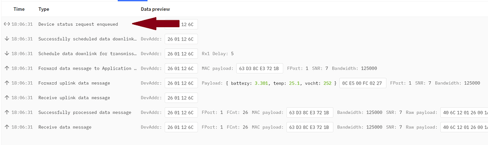

Is there somewhere a clear guide or example of how to set this flag. The provided documentation on the website is not very clear (at least not for me )
After some try-ing out I was able to create a new device with the CLI using the “mac-settings.status-count-periodicity” set to 1000. That didn’t help with reducing the device status requests. I still get for every uplink a downlink status request.
