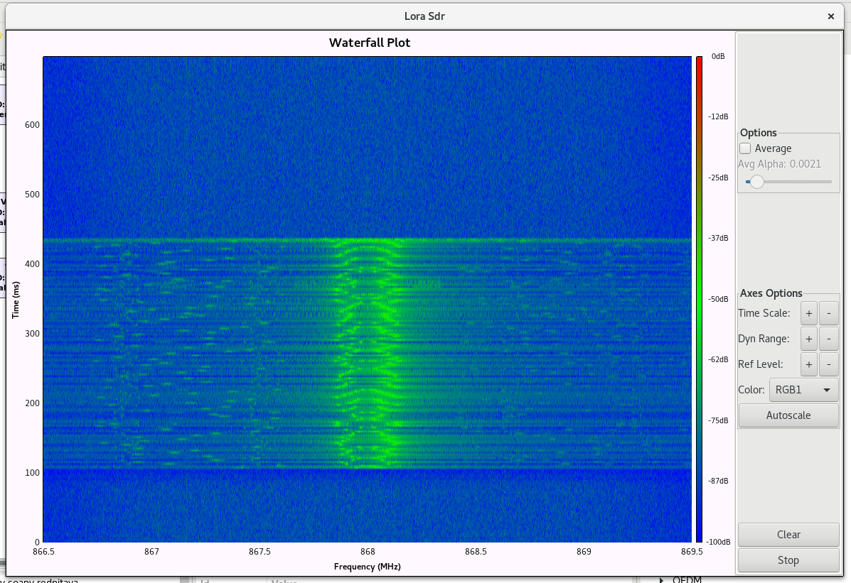

I’ve played around with this using an RTL-SDR USB stick which is very cheap. This picture shows the best resolution I’ve been able to get, that’s with SF12, any faster and the waterfall plot is too fast to make out anything much. I’m not sure if it would be better with a better SDR device (but they start to get expensive) or a more powerful PC that can produce the live plot faster or if I just don’t know enough about GNU Radio since this is the first and only time I’ve tried anything with it.
I’d say it is good enough to be able to see when something is being sent from the node. An SDR cannot replace a spectrum analyzer to properly measure the signal.
But as such it helped me to see that my Lora node actually sent something on the expected channels and was not broken.
Anyway I bought a proper 8 channel gateway and have succeded to get som packets through.
Very good work, I would advise you to use software like the SDRSharp that is easy to configure, in addition to improving the gain of your SDR in LoRa you can use a lamda / 2 antenna according to the frequency that LoRa works in your country.
Thx appreciate that, also thanks for your advice. I’ll look into using SDRsharp.
The antenna I got for the SDR in an Aurel GP868.
That antenna has a gain of 2 dBi, but it could be improved 4.76 to achieve with a lamda / 2
