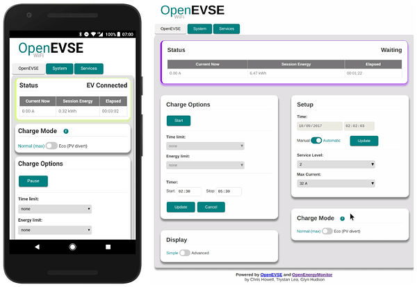

But LoRa(WAN) devices cannot transmit a lot of data (“uplinks” are very limited in both size and frequency/quantity), and sending data to the device (“downlink”) is even more limited. So there’s no way LoRa or LoRaWAN can replace the WiFi to support the built-in web server like the image below that I grabbed from their GitHub repo, if that’s what you’re expecting:
