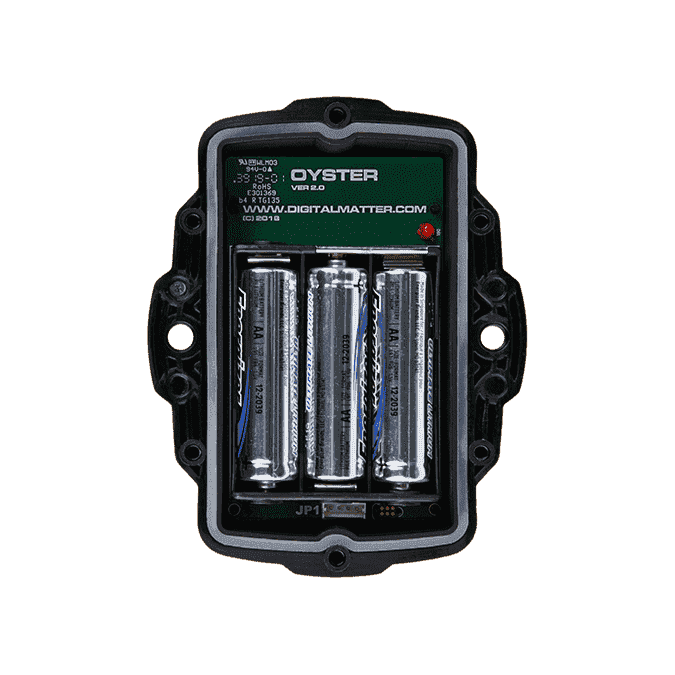

Hi @LoRaTracker, the ones that I use are:
They are LoRaWAN Certified so I presume that they maintain compliance to the regional regulations at all times.
thanks for the link - my browse of the interwebs puts these at around $100 which seems a good price. It is the ‘triggered’ nature of the sensor which is important to us, and a GPS theft alarm makes a lot of sense as an application requiring that reduced latency.

That would imply that the firmware in ‘LoRaWAN Certified’ nodes cannot be reprogramed, is that the case ?
Hi @LoRaTracker, my industrial experience is that if you need formal certification and commissioning then there will be limits on what the user can do without breaking the certification or commissioning.
In the case of the DigitalMatter GPS trackers the result appears to be:
- The user cannot change the hardware.
- The user cannot change the firmware, only install new [binary/closed-source] versions from the manufacturer.
- The user can use a wide range of configuration options to change the device behaviour.
Most makers reject this compromise as they need open access to the hardware and firmware.
Most industrial users accept this compromise as they need to reduce risk.
