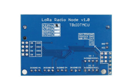

And an actual link to the actual hardware you are using, its not fully clear exactly which hardware ‘IOT-MCU V1’ actually is.
Is the IOTMCU V1 not the Lora Radio node V1.0? I see both names on the PCB.

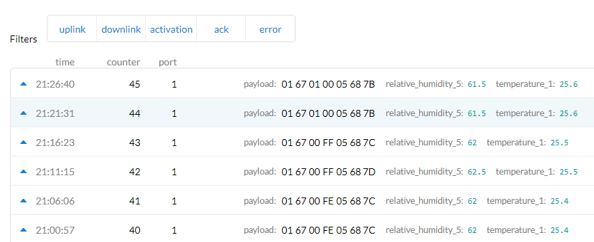

but mine is 886 MHz and since today good working with Cayenne: image
less then 5 uA in deepsleep… :sunglasses:
Well thats the board.
