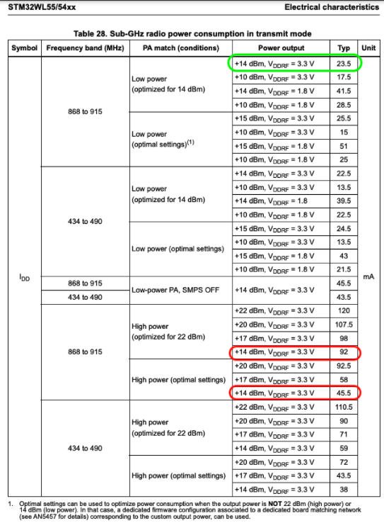

ahah you beat me, I didn’t even noticed this very interesting line in the datasheet in green below
Yes I think it’s correct with optimized hardware it should be possible and yes it’s a design flaw for EU868 in this case. Would be interesting to have though from @elsalahy and @cndrxn of generic node team

It is indeed the very reason why we’ve implemented both HP and LP RF paths on the Generic Node. In most of the use cases +14 dBm (LP) output is more than enough and it provides huge energy savings.

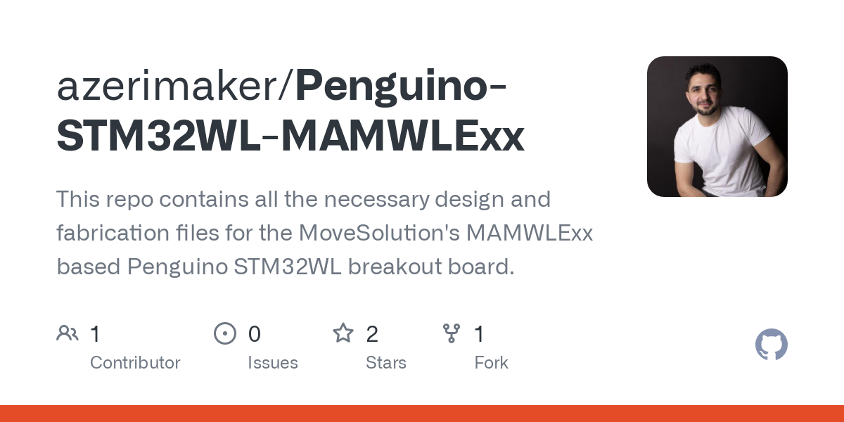

FYI, there’s another STM32WL module available from Move Solutions and it’s called MAMWLE-C1. It’s a bit pricier, but breaks out all the available GPIOs and has support for both LP and HP RF outputs.
A while back I’ve designed a Feather breakout for it:
Thanks @cndrxn , good to know, would be interested to have some Penguino for testing, let me know how if you know.
BTW I ordered 2 Generic Node, did you had a chance to confirm approx 25mA at 14dBm EU868 ?

Thanks. I’ve soldered couple of MAMWLE Penguinos recently, and yes @descartes they will be available on Tindie soon. I’m having hard time finding some parts to prepare more RAK4260 versions.
@Charles, GN runs at +2.8V therefore the current consumption will be slightly higher. We’re seeing ~35mA @+14dBm on VDDRF, and you always have the possibility to switch to HP output for longer range (US only).

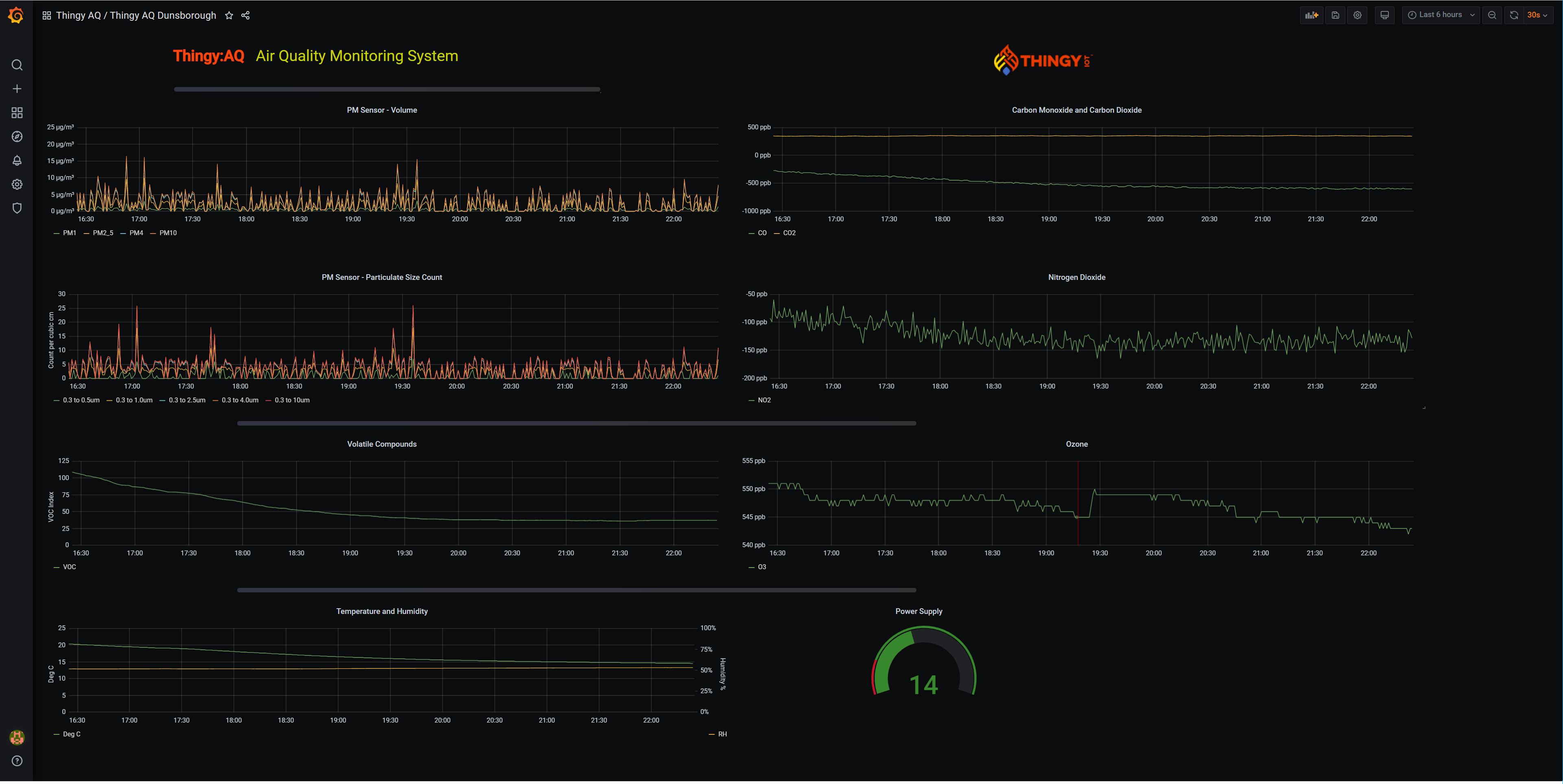

The product was developed as part of a geographically dispersed system for monitoring Wildland Fires and for studying the effects of fires on communities. The background of it is here in this blog: https://www.brushelectronics.com/blog/ and the resulting commercial product is here: thingy.us
There are a few different options for presenting the data, managed, unmanaged, some hosted, some not. This graphic is from a unmanaged site in Western Australia that is hosted on customers own hardware. For confidentiality reasons I edited the graphic and removed some gauges, as well as status and location information. Capture
Looks remarkable like a Dunsborough profile to me :wink:
Dunsborough yes, but the location is not specific enough to identify the property where the node is deployed.
