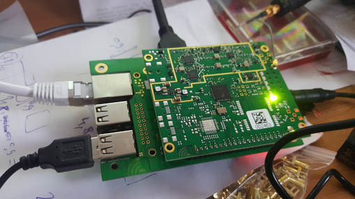

No the power supply comes from IMST it self. I wanted an all inclusive hardware to avoid too many newbie questions… not a good idea :slight_smile:
I’ve opened the box to ease the SD card swaps.
It looks as it is a basic RPI 2 or 3 + iC880a
This is weird and I’m a bit stumped with this one. Already tried:
  • Setting reset pin to match adapter board photo (GPIO5, pin 29)
  • Use the lora_gateway + packet_forward from @gonzalo’s setup, which I also use in 3 other gateways (even more in the past)
  • Using latest lora_gateway package (4.1.3) and corresponding packet_forwarder (3.1.0)
  • Tried every reset pin available on the PI just in case
  • Enabled full debugging on libloragw
But it’s stuck with:
lgw_spi_rb:372: BURST READ: to trans 2048 # chunk 1024 # transferred 7168
lgw_spi_rb:372: BURST READ: to trans 1024 # chunk 1024 # transferred 8192
Note: SPI burst read success
ERROR: Failed to load fw 1
Note: SPI read success
Note: SPI write success
ERROR: Version of calibration firmware not expected, actual:0 expected:2
ERROR: [main] failed to start the concentrator`

Interesting.
So now try changing the server line in local_conf.json to
“server_address”: “router.eu.thethings.network”
Look like the concentrator is working. I read this in the logs
" [main] concentrator started, packet can now be received "
Mar 21 19:12:26 LoRaGateway lora_pkt_fwd[630]: INFO: packets received with no CRC will NOT be forwarded
Mar 21 19:12:26 LoRaGateway lora_pkt_fwd[630]: INFO: [main] concentrator started, packet can now be received
Mar 21 19:12:26 LoRaGateway lora_pkt_fwd[630]: INFO: Disabling GPS mode for concentrator’s counter…
