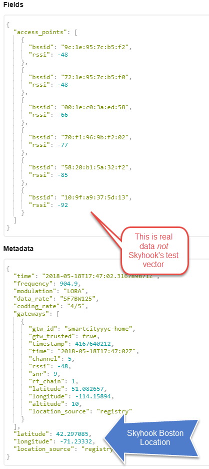

Thank you @Oliv. Sorry for the delay but I’ve been working on other stuff - now want to finish this up. I ensured the configuration matched yours. I did eventually get the results I expected and you got - the location near Boston corresponding to Skyhook’s test vector. It did not work immediately however - to get the end-to-end location working I had to delete the device in Cayenne and create a new one.
There is some sort of caching going on somewhere in the chain. Now, I have replaced the Skyhook data with real data, that has worked before with Skyhook’s location system. What I’m seeing is that the ‘Metadata’ shown in the Console’s Application Data reports the old Skyhook test data location. See the screen shot below.
Anyways, all I know is that the TTN console still thinks the device is in ‘Needham Heights’. Somebody is caching this old location?
