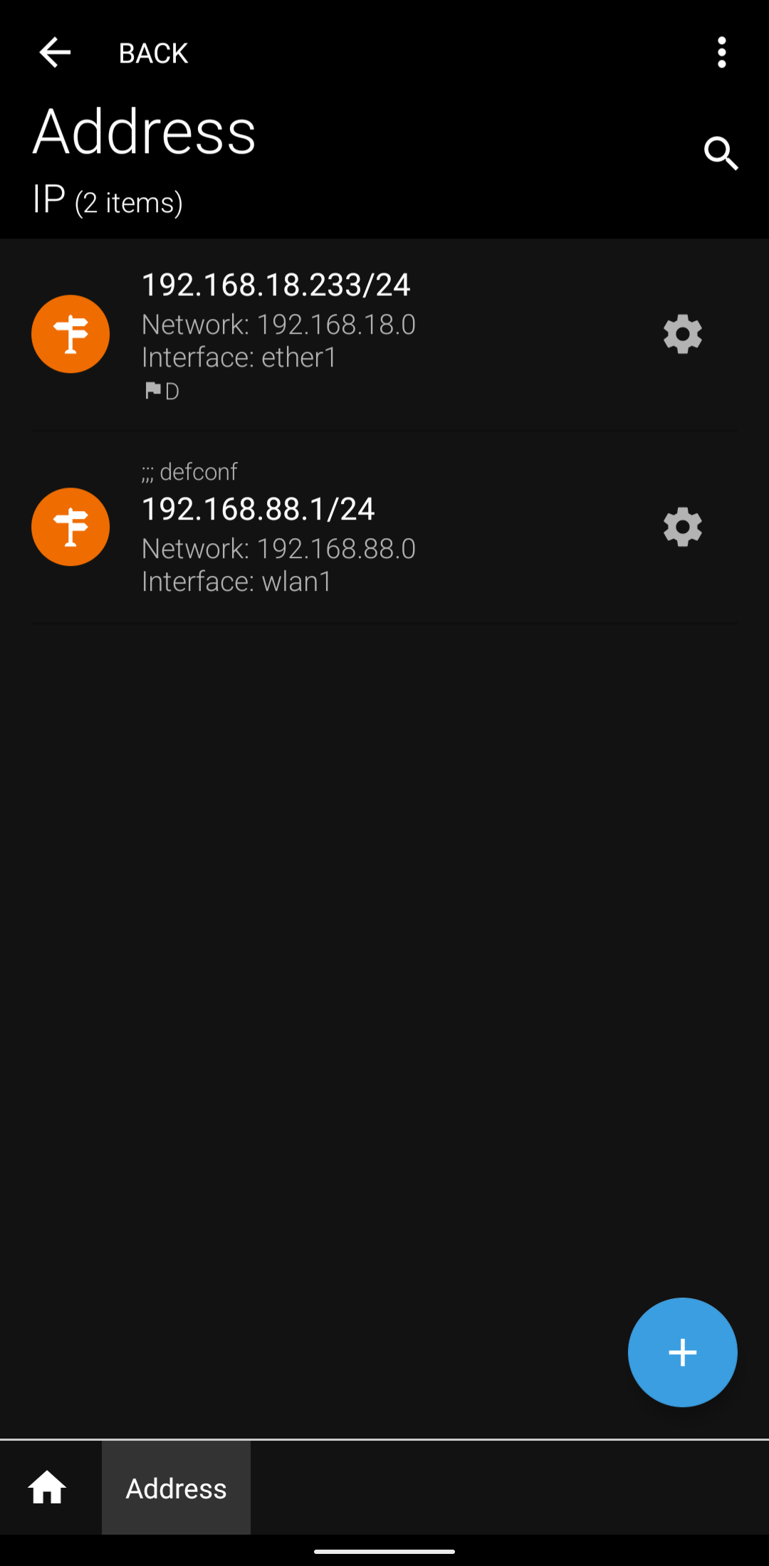

So now I have one more question for next image:
Screenshot_20220710-124929
These are IP addresses from gateway, the one that it gets from dhcp via ethernet from local network router, 192.168.18.0 where is set my virtual machine via bridge mode to host (192.168.18.2) and network that creates the own gateway (192.168.88.0).
I’m not able to ping dhcp IP from gateway(192.168.18.233), neither ping from gateway to virtual machine’s IP(192.168.18.2 = server address).
Is it possible that i must set virtual machine’s IP, it’s means being connected to wi-fi from gateway (192.168.88.0), to could have that connection between them? And making possible that state of connected y tts?
Pd: I cannot make ping to 192.168.18.233 from my host neither

Yes, I’m able to ping router, my pc and every device in 192.168.18.0 both sides but not gateway(192.168.18.233). No one from my network can ping gateway.
The way I config it, connecting it’s wi-fi, make me think that I must be connected to it for receiving an IP in his network (192.168.88.0).

MikroTik gateways are configured to consider the wired network as WAN so it won’t respond to ping or other connections. You can change this if you want but it’s not required.
From the gateway can you ping the VM?
No I’m only able to ping router (192.168.18.1), because it’s connected via ethernet. I cannot ping VM, pc, or any other device in 192.168.18.0 network
I would start by reconfiguring the MikroTik to have it use the wired port as LAN port.
