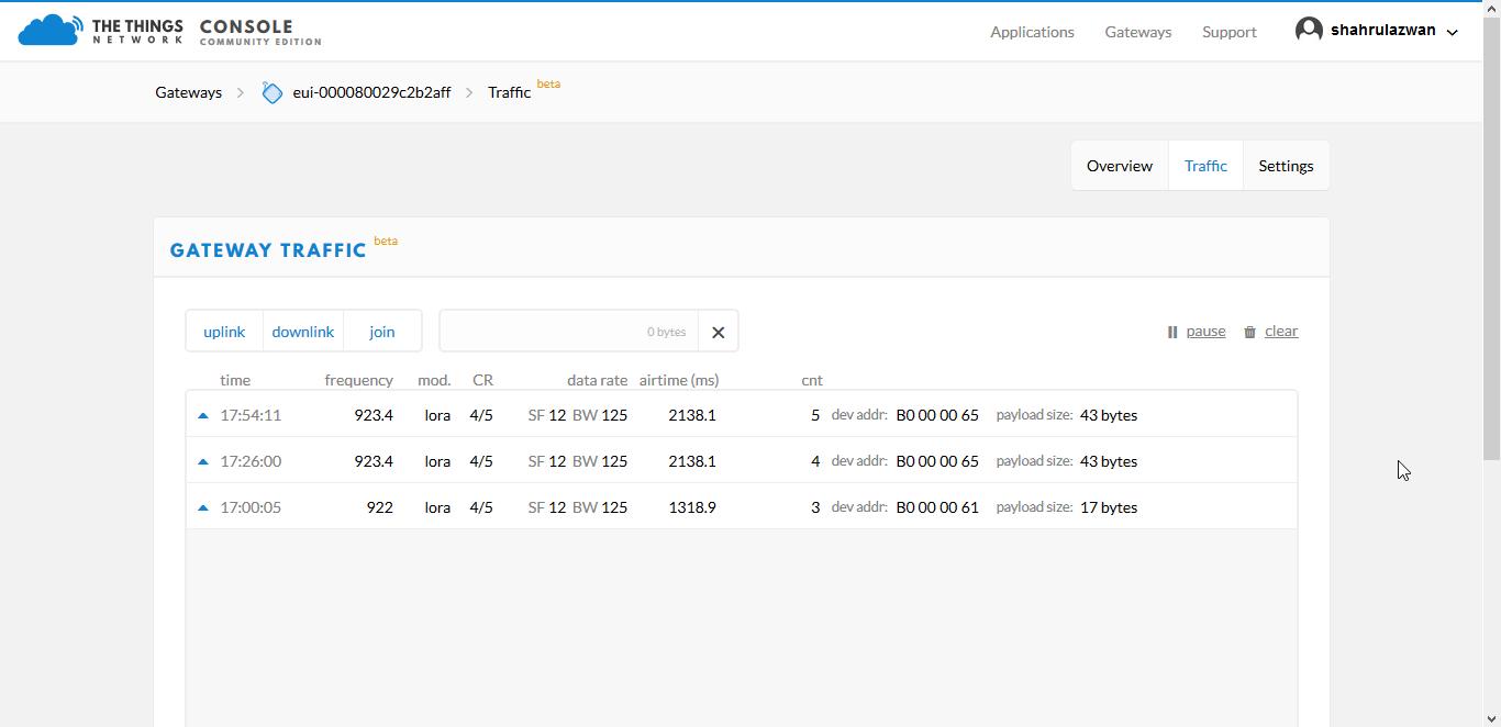

Hi… I have similar problem with my sensor. The sensor that I have already with a prefix DeviceAddress (Address: B00XXXXXX), Application Session Key and Network Session Key. According to the manufacturer, the sensor is configured with ABP.
When I added the sensor to TTN using TTNCLI and force change the Device Address to the sensor Device Address, I couldn’t get the publish in TTN. The instruction that I used to change the Device Address
ttnctl devices set [device_id] --dev-addr [sensor_device_address] --handler-id ttn-handler-asia-se
As i’m using Asia server, I need to put the --handler-id, else there will be error in the process.
Is there any solution for this?
A DevAdrr that starts with B00 will never work with TTN, see the explanation above. You’ll need to reprogram the device to use the TTN-assigned DevAddr for ABP. Or make it use OTAA and configure TTN and the device to use the same values for DevEUI, AppEUI and AppKey.
Hi… Thank you for the feedback. Although the data is available in the gateway traffic, application level, the data can’t be shown in the application due to the network identifier?

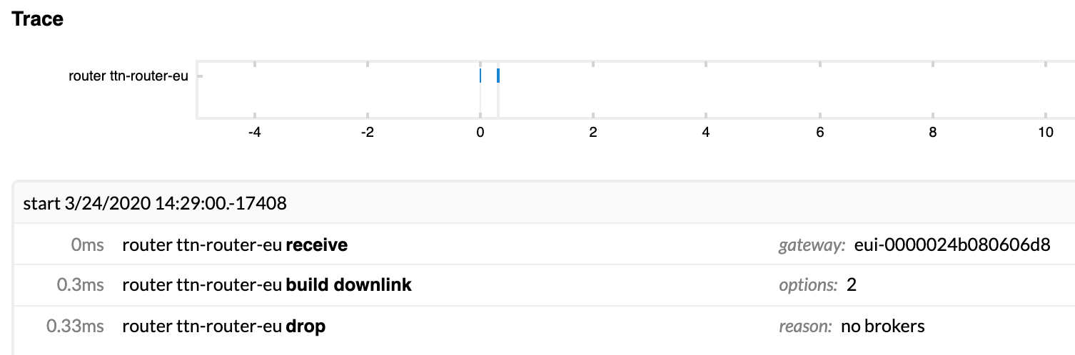

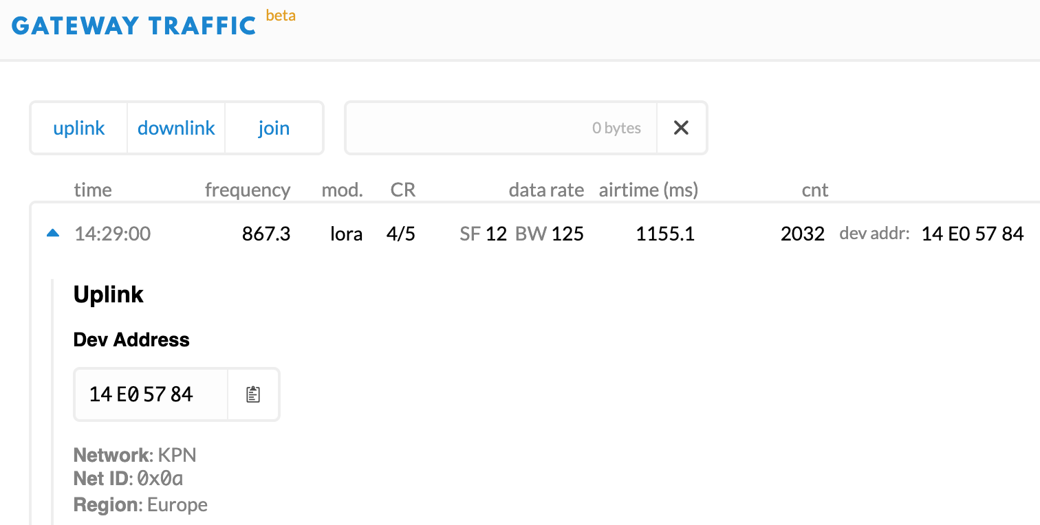

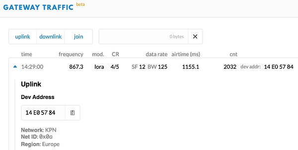

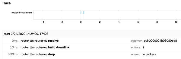

If you don’t believe it, then click on an item in the gateway traffic, to see that (in your case) TTN will not recognize this as traffic it needs to handle. For example, for a DevAddr starting with 14:
…and the “drop” along with the reason “no brokers” in:
The data can not be forwarded to any application because the address is not valid for TTN.
