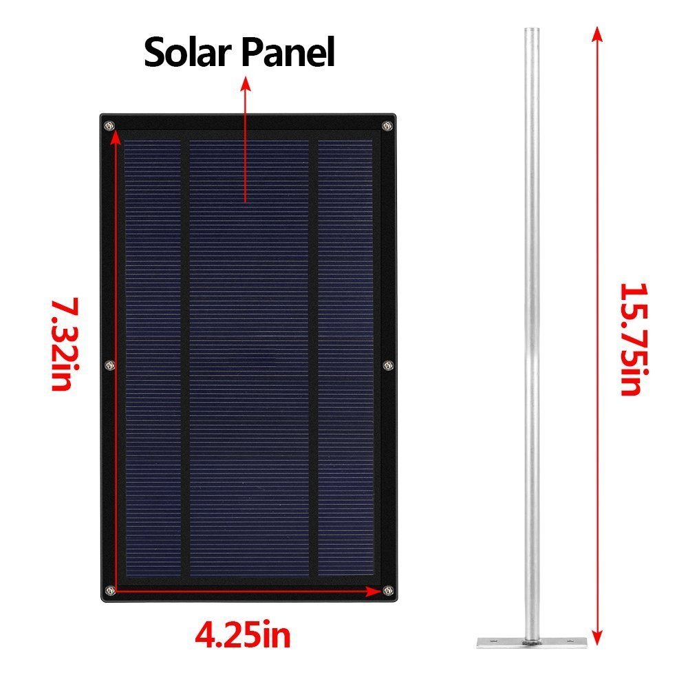

I bought this one to tear apart.
let’s see if there is enough room.
the specs are perfect
Solar panel: 6V, 1.8W
Li-ion battery: 3.7V 2400mah !

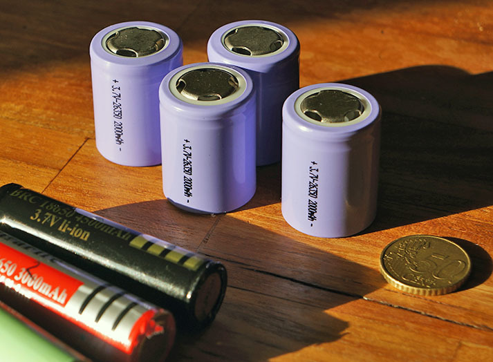

Where is the external antenna
new model 26350 rechargeable Li-ion 3.7 v - 2000 mAh

You are same kind of evil than @BoRRoZ to find them in France ! I will buy a set too ![]()
Edit: even better !
Edit: even better !2
@oliv I saw these 4 one, but I’m pretty sure they’ll be send from China, not France, that is why I choose Amazon direct, they are evil also ![]()

I’m liking the solar light idea for my LoPy node. Has anyone tried one of these yet?
2.5 watt solar, 2600ma battery (claimed)

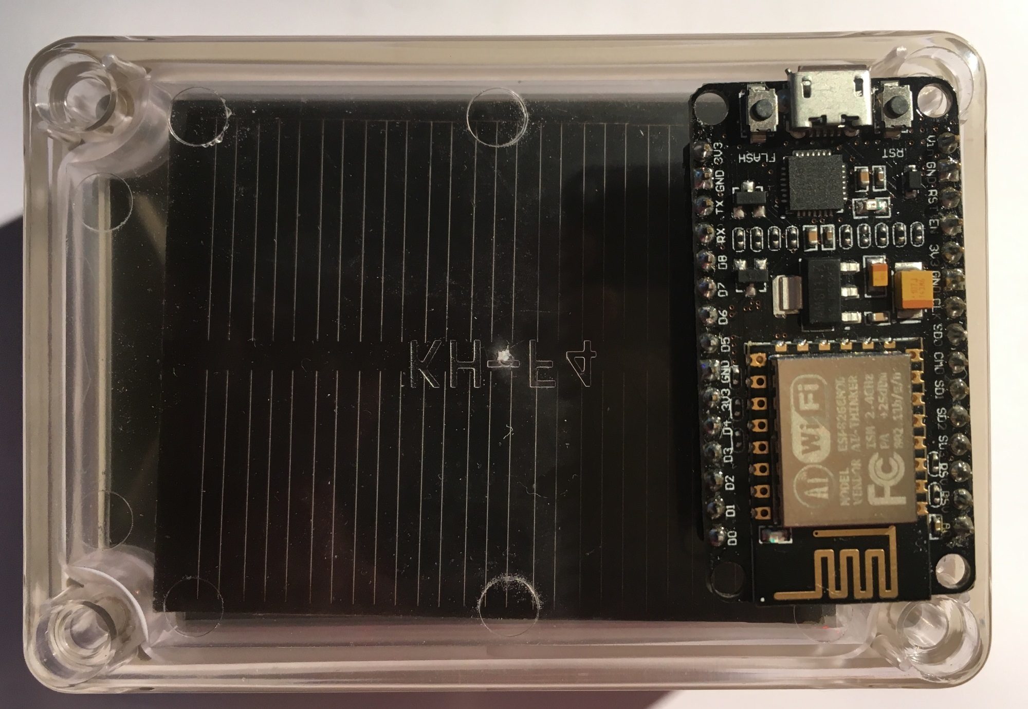

I’m thinking ’ why not make a transparant solarpanel/node combi enclosure myself, with the help of a simple technique ‘vacuum forming’

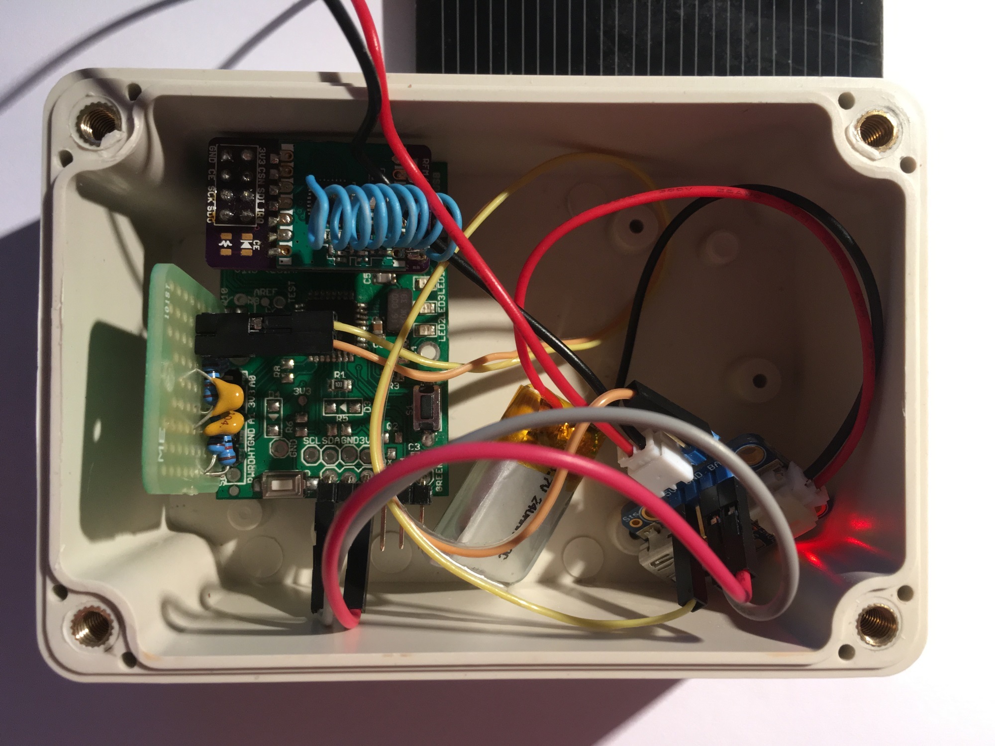

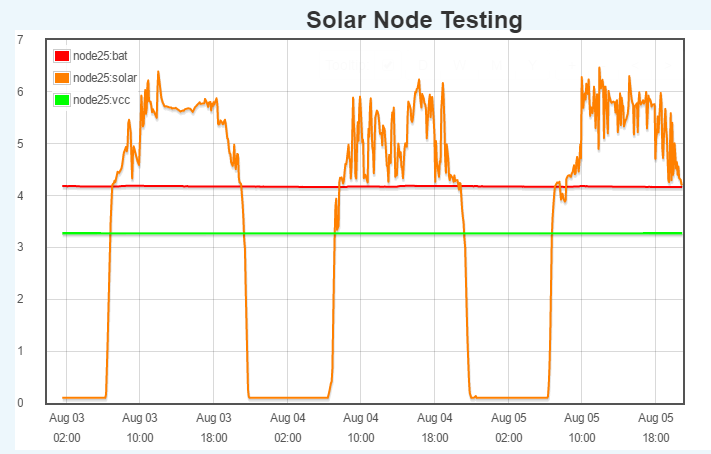

I just recycled early ULPNode prototypes to test and measure solar/lipo
All is done with custom classic Atmega328 early ULPNode prototype with
RF Transmit is done every minute and LED is blinking every 8S (Watchdog wake), so it really not “Ultra Low Power” but I want to see how how far can we go with this not optimized settings
Inside
All mounted (nodeMCU is just for "size view)
Live view started
Dashboard published, you can follow and access them any time here if node and battery survive to this night
PS click week on dashboard since data shows default for year.

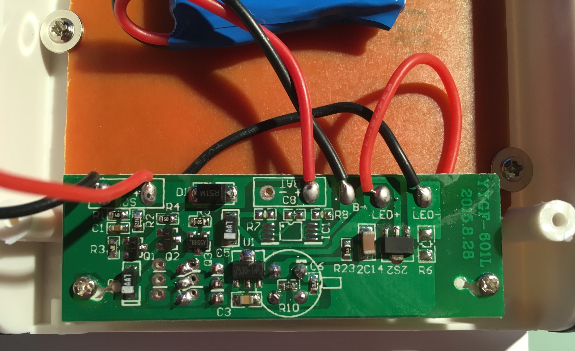

Got my Amazon gift today Solar Outdoor light talked above, seems pcb have changed
Seems the Lipo has lower size also (lower capacity?)
thank telling me about the on switch amazing to find it (but it clear on documentation we all must read it
where is IC 1 ?
I swear, I didn’t hacked it and removed, but I don’t know, what was it for?
check your other solarlights… if they all are the same it’s a feature by design and not a mondaymorning production

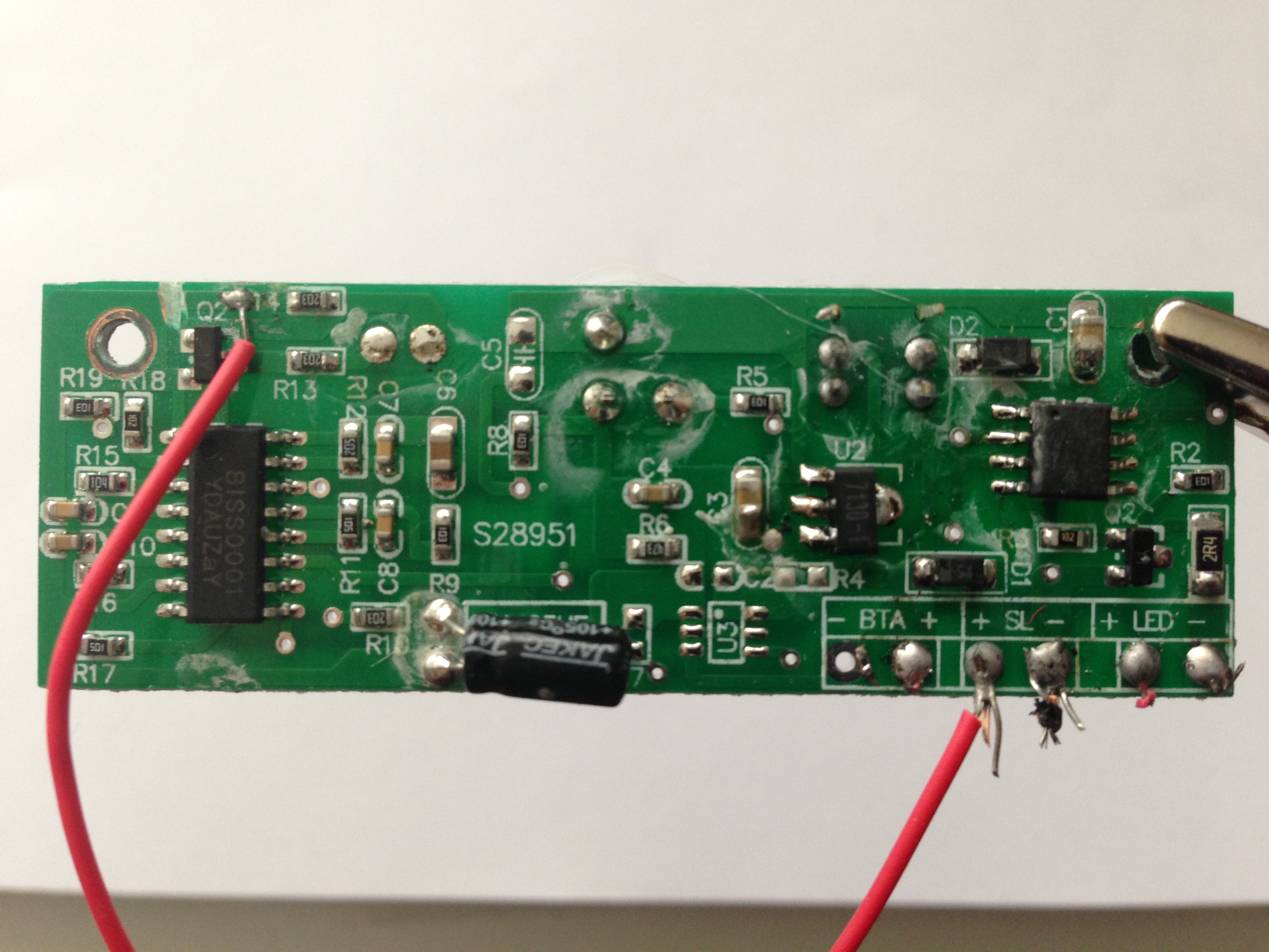

Here an other board out of the Solar_Wall_Light from Interdiscount in Zurich
LiPo has 900mAh
Humm, this one shows that “waterproof” word can have different appreciation

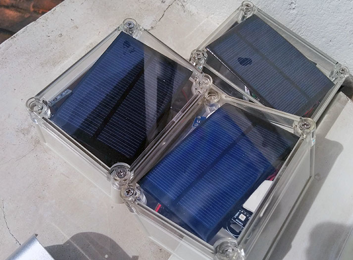

about waterproof enclosures for little chinese panels… be carefull because when they are the whole day full in the sun, it gets to hot inside the waterproof (airtight|) plastic box, the panelcapacity can decrease 15-30%…

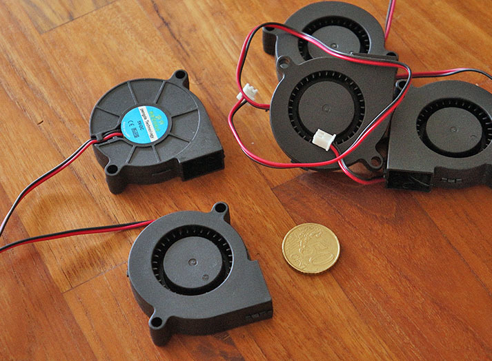

I bought these little fans and my plan is to build one in the enclosure and switch it on a short time @ a certain temp, maybe controlled by a bi-metal and a transistor (not tested yet)
Another possibillity is drill a few holes in the bottom
