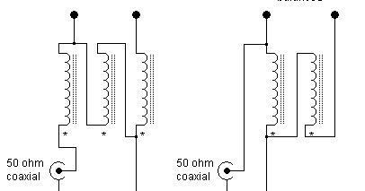

Dipole would require a balanced signal. When you want to use a dipole antenna you would need to have a balun to convert between transmission line and the differential dipole. So it is not as easy as soldering just two wires.
Most of the antennas for LoRa transceivers are monopoles and require proper grounding.
